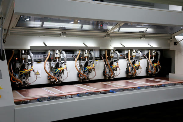

Mechanical drilling uses a rotating carbide drill bit, typically spinning between 60,000 and 160,000 RPM, to physically cut through the panel. It is the default method for standard through-holes and remains responsible for the large majority of holes on any given board, because it is the only method that can economically drill all the way through a thick panel.

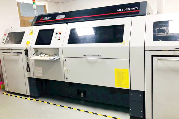

At PCBgogo, this thickness-dependent scaling is built directly into the DFM check rather than left for the designer to catch: standard mechanical drilling covers 0.15mm to 6.3mm with a ±0.08mm finished-hole tolerance, laser drilling for HDI microvias goes down to 0.1mm with resin-plugged blind and buried structures and hole-wall copper held to at least 18 microns, and the thickness and copper-weight constraints above are checked automatically against the submitted stack-up before production starts.
PCBgogo's advanced drilling equipment

1. Panel preparation. Laminated panels are stacked with an entry sheet on top (usually aluminum, to reduce entry burr and dissipate heat) and a backing board underneath to reduce exit burr and protect the machine bed.
2. Program load and datum setup. The drill program, generated from the Gerber and drill files, is loaded, and the panel is registered to fiducial or tooling holes so every subsequent hole lands relative to a fixed datum, not relative to the raw panel edge.
3. Test drilling. A small sample run verifies hole size, position, and wall quality before committing the full panel.
4. Production drilling. Holes are cut per the program, mechanically or by laser depending on hole class, with tool changes scheduled to match drill-bit wear life for the material in use.
5. Desmear. Heat from mechanical drilling melts a thin layer of resin onto the hole wall. A chemical desmear step removes it; skipping or shortcutting this step is one of the more common causes of intermittent conductivity failure after plating.
6. Deburring. Copper burrs raised at hole entry and exit during drilling are mechanically removed.
7. Inspection. Hole size, position, and wall quality are checked against the drill table before the panel moves on to plating.
