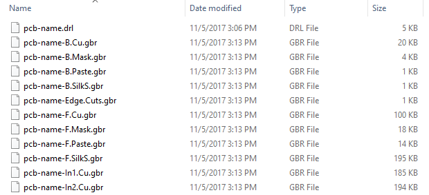

Each Gerber file describes a single layer of the PCB as a 2D vector image. A complete PCB design is typically packaged as a set of Gerber files (one per layer) compressed into a .zip folder. Files use the .gbr or .ger extension.
Gerber file on computer
Gerber File Layers: What's Inside the Package
So what exactly goes into that zip folder? A typical Gerber package contains one file per layer, and each layer serves a specific purpose in the manufacturing process. The table below breaks down the most common layers, what they do, and the file extensions you'll typically see:
LayerFunctionCommon Extension
Top CopperTraces and pads on the top side.GTL
Bottom CopperTraces and pads on the bottom side.GBL
Top Solder MaskExposes pads for soldering (top).GTS
Bottom Solder MaskExposes pads for soldering (bottom).GBS
Top SilkscreenText, logos, component labels (top).GTO
Bottom SilkscreenText, logos, component labels (bottom).GBO
Board OutlinePhysical edge/shape of the board.GKO / .GM1
Drill FileHole positions and sizes (Excellon format).TXT / .DRL
Note: The drill file (Excellon format) is technically a separate format, but it's always included as part of your Gerber package submission. Missing it is one of the most common reasons manufacturers reject a file set.

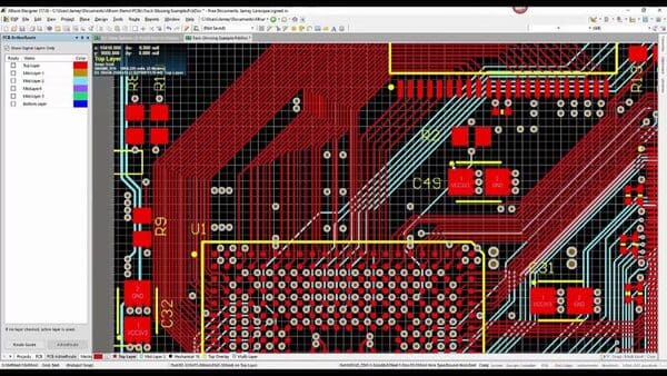

Altium Designer
1. Open your PCB file → File → Fabrication Outputs → Gerber Files
2. Set units, format (RS-274X or X2), and select layers
3. Generate drill files separately via NC Drill Files
4. Output goes to your project's Fab folder

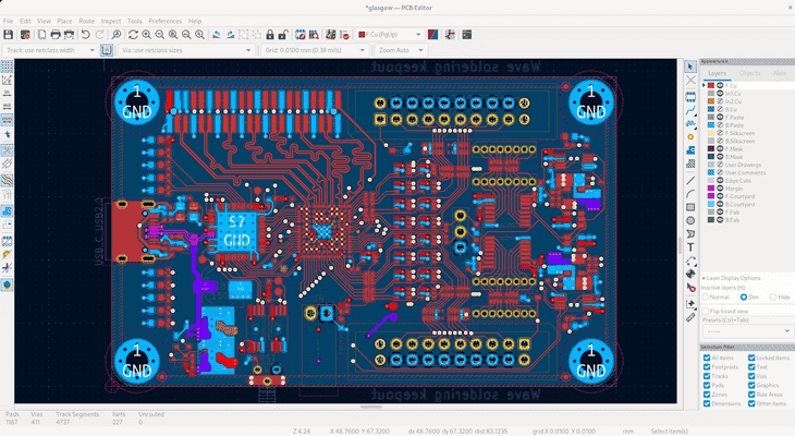

KiCad
1. Open PCB editor → File → Plot
2. Select Gerber format, choose layers, set output folder
3. Click "Generate Drill Files" separately
4. Review output in the built-in Gerber viewer before zipping

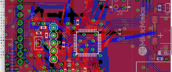

Eagle
1. Open board file → CAM Processor
2. Load a standard Gerber job file (e.g., gerb274x.cam)
3. Process all layers and export

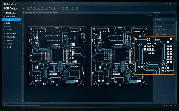

How to View and Verify Gerber Files
Never send Gerber files straight to a manufacturer without reviewing them first. A misaligned layer or missing drill file can result in a scrapped order.
Recommended free viewers:
  • PCBgogo Online Gerber ViewerNo software download needed. Just drag and drop your zipped Gerber files and instantly see a rendered preview of every layer, right in your browser. It's a fast way to double-check your files before submitting an order.
  • gerbv — Open-source, offline, lightweight. Great for quick checks.
  • Altium 365 Viewer — Free online viewer, no account required. Handles most formats.
  • KiCad PCB Viewer — Built into KiCad, accurate rendering of your own exports.
What to look for:
· Are all layers present and visible?
· Do copper layers align with solder mask cutouts?
· Are drill holes centered on the correct pads?
· Does the board outline form a closed shape?
· Are units consistent (don't mix mm and inches)?
